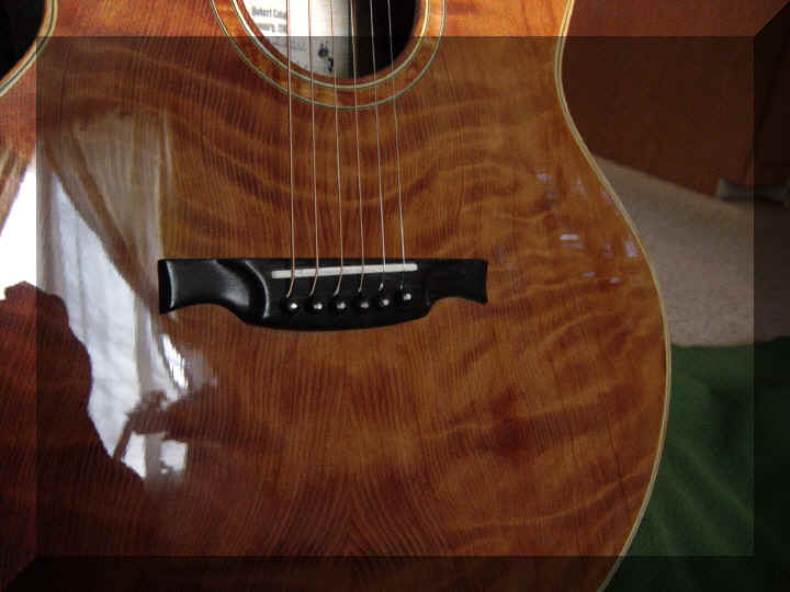

I have built a couple of classicals using redwood (not the fabled LS, though), both with padauk back and sides. Here's one of 'em:
This was my third build. I used a standard 7-fan pattern to brace the top (Euro spruce bracing). It has a big sound, with resonant basses and good trebles.

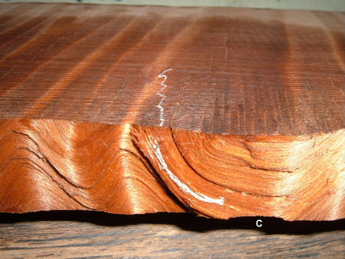

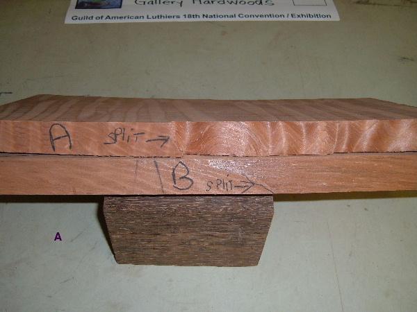

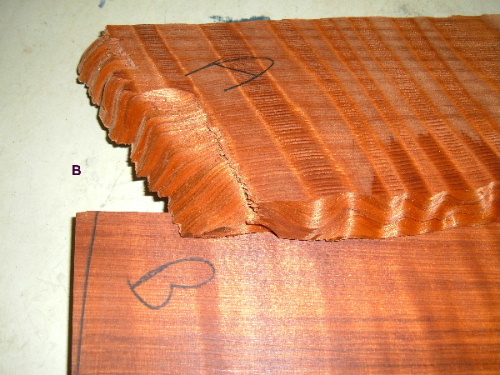

Here's some photos to illustrate curly redwoods inclination to show endgrain on the surface as Bruce stated.
In photo "A" there are two almost identical looking pieces from the sawn left side edge grain appearance. One has deeper curls than the other obviously.   On the right side you can see where I've hand split the edge to reveal the true nature of the undulating grain. "A" is not acceptable as acoustic soundboard use (in my opinion), while "B" shows fairly straight grain with little run out. I would have no problems calling this acoustic grade curly redwood.
In photo "B" you can see how precarious the deep undulating grain In wood sample "A" really is. The break follows the grain.
In photo "C" look for the white marks that highlight an end grain split in the surface..actually several of them. Follow the grain split carefully and you see it follows the grain right up to the surface. This checking can occur almost anytime, but think of how weak the board really is at these points. There certainly are stronger points in a board, and the crap shoot comes when the bridge is located. Maybe it's a stronger point that will hold or maybe not.
I'm not saying the sky is falling on curly redwood, but consumer education has merit in my book. Be very careful buying curly redwood off eBay or other un-proved sources if you want to reduce the risk. The OLF sponsors are a great group of responsible, knowledgeable folk and you can bet they've checked the quality of their curly redwood offerings. Good luck!!
